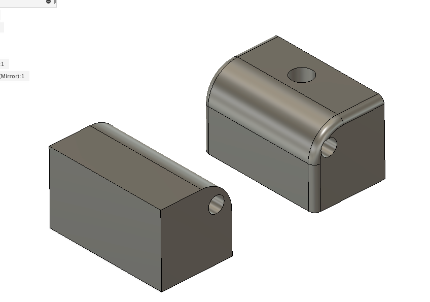

I don't see a Mirror Component in your timeline.  If you actually use Mirror Component, you can definitely modify the mirror copy or the original downstream of the mirror:
