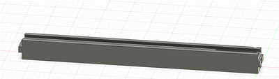

I have an extrusion which I want to print with a 3d printer. The extrusion is too wide to print in one rush so I want to split in two parts with a simple connection.
Let's call them extrusion A and B
You can see A in the picture below. The connector from A to B is on the right side

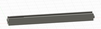

Extrusion B shall be the same as A just mirrored. Like in the picture below
But the connector part should not be mirrored. I want to sketch the receiving part now.
How do I mirror my extrusion w/o sketching it a second time?

After the mirror, do a combine cut of the mirrored body and check the keep tools box.
davebYYPCU
Delete the extrusion 3, that makes the joiner block - tab.
Copy Paste New - the A Component.
On Component A, redo Extrude 3.
On Component B, Make the socket from it's extrude sketch.
You will likely have to mirror Component B body to make Extrusion 4 go to the correct side.
Might help....
