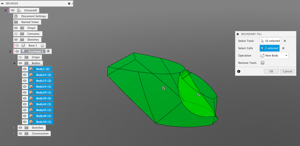

Good day,
I am trying to convert my surface model to a solid model, but I am getting a free edge and I cannot manage to resolve it. Stitching fails and I cannot identify the hole to patch. I have included the file.
I would appreciate some help on this one. This is my first surface model, so I am learning.
Thank you,
Joe
931 Views
wmhazzard
You need to trim the lower half of body1 (2) with body30 (5).
TrippyLighting
Or, as an alternative workflow, you could use the boundary fill tool and window select all the surfaces.
josephhhaines
Awesome! Worked - and two workflows to do it - great learning.
Thanks again.
