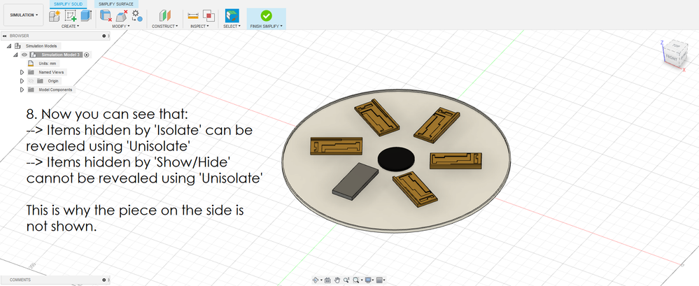

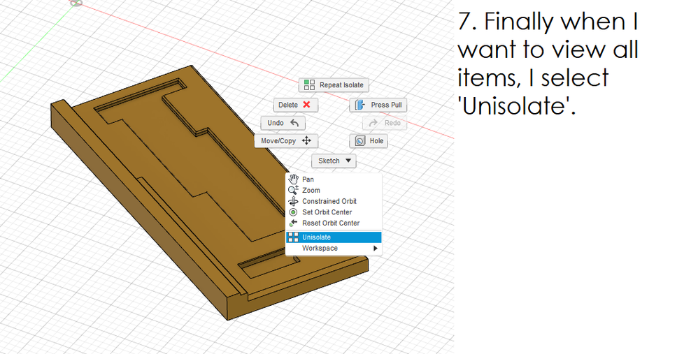

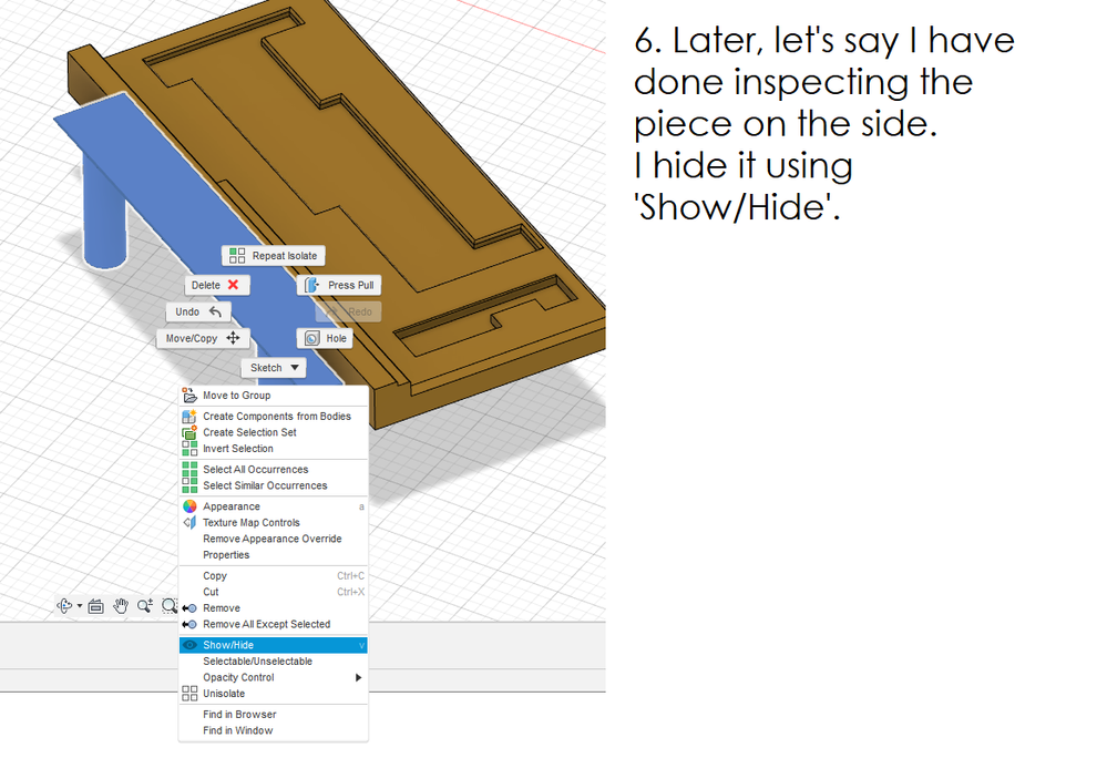

3. The 'Isolate' and 'Unisolate' pair works fine in most cases. However, when 'Show/Hide' function is involved, the 'Unisolate' function becomes unreliable on showing all items.
Example 1: I use 'Isolate' on a number of components. They are basically a group of objects in contact, therefore I would like to inspect them as a whole at first. Then I might need to hide one of them to better view the others, therefore I used 'Show/Hide' on it. Now, when I want to reveal all items, 'Unisolate' fails to do it. The object hidden by 'Show/Hide' function is still hidden.
In short, 'Unisolate' does not work perfectly when a combination of 'Isolate' and 'Show/Hide' exists. Therefore we need a function to 'Show everything' which literally shows every item regardless of which function is used to hide it.
