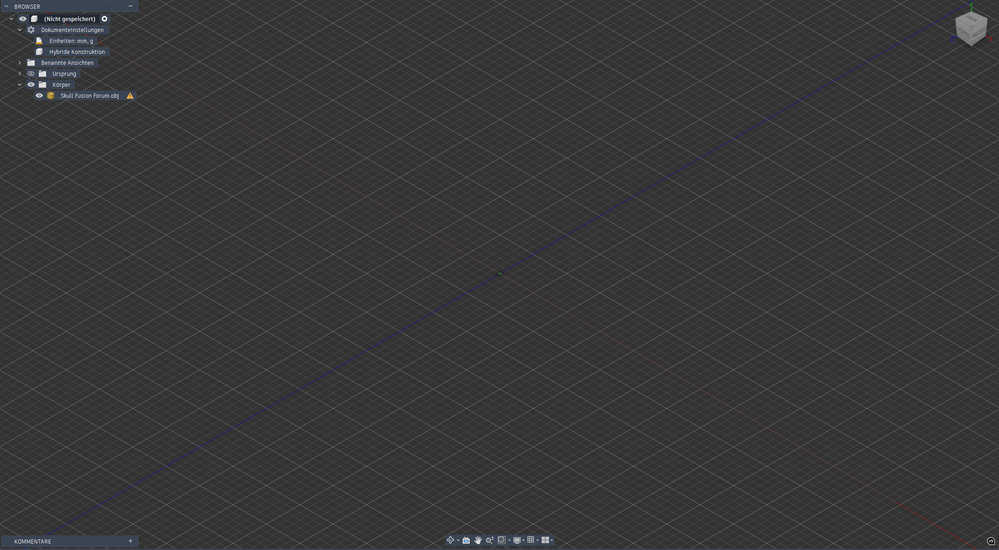

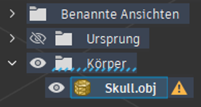

I have been trying to import an .obj into fusion and no matter what .obj i try, fosion is never able to display it and gives a "negative voluem" error.
It cant be the .obj files I tried a lot at this point and they open fine in other programs.
I did even export blenders standard cube as .obj and fusion cant even open that.
Could someone give me confirmation that this isnt just me?
Thanks in advance.

RuvenBals
Sure, thanks for the reply.
The skull is what im ultimatley trying to import. The cube is just blenders cube.
The screenshot shows what I see. Nothing and a non positive voleum warning.

That is odd. The object shows in your browser. When you select the mesh object in the browser, do you see anything changing in the viewport?

RuvenBals
What Happens on my end.

TrippyLighting
@johnsonshiue Not sure this is a bug or perhaps graphics driver related. The mesh model is clearly inserted into the design, but is not visible in the viewport.

TheCADWhisperer
@TrippyLighting
When I open the file in Message 7 all I see is a line.
There must be something wrong in the OPs machine as the obj opens for both of us without the warning triangle.

RuvenBals
You guys are right it seems to be my PC.
The file opens perfectly fine on my labtop.
My workaround now is to open .obj's on my Labtop save the file and then open that file on my PC. A little anoying but I can atleast work on my PC that way.
