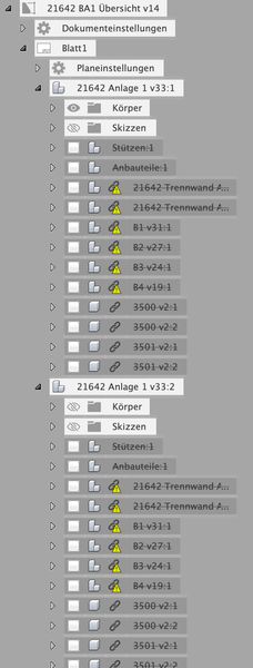

The referenced Fusion file used to create the drawing is suddenly automatically changed to a different file.
The browser of the drawing before the bug is shown below:
After the file was reopened the referenced file has changed
In the file browser, the correct file is still displayed and does not match the file in the drawing.
The problem occurs with both the latest Windows and Mac versions of Fusion, and also with other drawings. It seems that the file of the first view is always used as the referenced file and the file used to create the drawing disappears in the drawing. This change is retained even without saving the file.

Hi @tim64YBY
I'm sorry that you have been affected by this problem. The development team has just deployed a hotfix for the problem, which should be available today. Please check to see if there is an update for Fusion 360.
Once it is available, please update and let me know how you get on.
