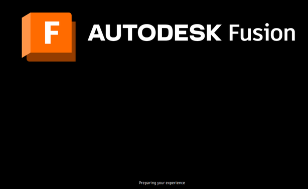

Fusion Error Report during start-up. This has been happening for a few weeks, but because Fusion continues after I send the error report, I have not investigated further.
The latest error report ID is 819483987.
The error appears during the setting your experience phase of start-up.
Anyone else experiencing this?

Resolved. I used the following steps:-
  • Uuninstall Fusion and all Autodesk related programs.
  • I followed this up removing files and folders from locations like C:\\Users\\?????\\AppData\\Local\\Temp and C:\\Users\\?????\\AppData\\Local\\Autodesk\\Identity Services.
  • Final step was to delete registry keys related to Autodesk Fusion 360 from the Windows Registry.
After re-installing all was back to normal.
