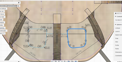

Idk what happend but ever since last update fusion has been showing me wrong dimensions in certain points
like here in the pic down blow i dont understand how or why the dimesions are off of these offsets even tough they the offset on the right is a mirror of the offset on the left and as u can see the inner lines show 5.313 mm while the outter lines show a difference and i know itss such a small figure of 0.007mm but still it is present their completly destroys my trust in the software i would really appreciate if someone can help me with this

Who said the purple projections are correct?
if you only do half the work, and mirror at the end, all will be aligned.
sketch mirrors and sketch fillets are not recommended workflows.

the issue is that everytime i draw a line from that straigt line to the edge like in that pic where it was showing me 9.502 it shows me a different reading which has a variation like 0.007 or 0.002 something like this
