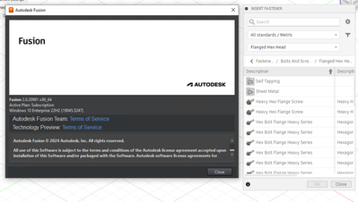

Community Visitor
just got the file not found error again ? i'm working with the latest update
2.0.20981 x86_64

Hi  info6VKF,
 it looks that your installation is somehow corrupoted in other words , we can reproduce on our side a similar issue if file index.html or whole folder
%LOCALAPPDATA%/Autodesk/webdeploy/production/bce2902bbfcb27678033cbb9e17a3529631b97a7/LibraryClientPlatform
doesn't exists.
Please, could you verify if the folder above and index.html inside this folder exists ? If not, we suggest to do a Reinstallation or Repair Fusion by Fusion Service Utility.
Please let us know if this fixed you issue.
