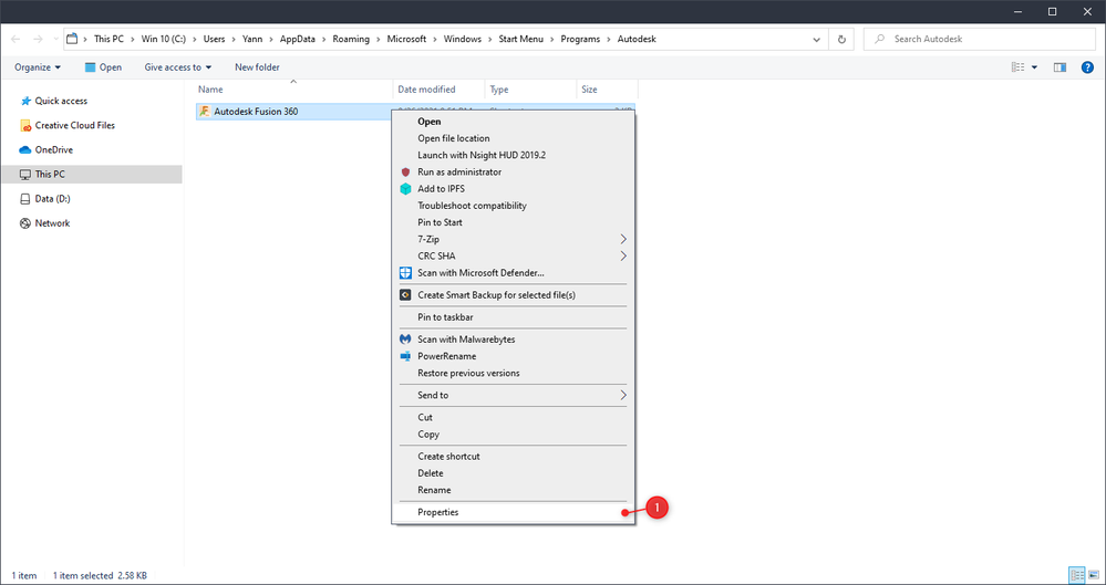

yann.masoch
Hi, this issue is still the same in Feb 2022 but I'd like to share a solution I found today for Win 10 (I don't if this solution works for other Windows versions or for Mac).
  1. Right click on Fusion App/Shortcut and open Properties
  2. Click on Change high DPI settings
  3. Check the box Override high DPI scaling behavior. By default, I kept Scaling performed by: Application
  4. Press OK and OK to close the Properties windows
  5. Restart Fusion
  6. Now, full-screen works!
    Enjoy 😉
