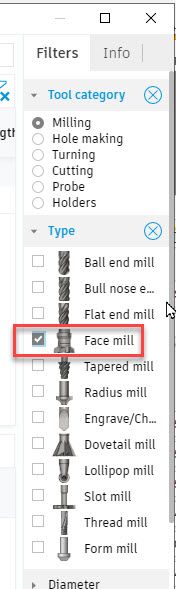

I am new to CAD/CAM and am trying to get up and running on my new Onefinity CAD machine. I am trying to learn Fusion 360 and am about to run my first job. I have my design done and have moved to the manufacture portion.
In tool selection I have down loaded Whiteside Tools library and have selected a 1" surfacing bit to surface a piece of stock. after I select the tool from the library I receive an error message, "tool (form mill) not supported for Face Operation."
What am I doing wrong???

If you are doing a Facing operation, you cannot use a Form Mill you need to select a Face Mill.  This is why is rejecting the tool.

Thanks John, The bit is actually a spoilboard surfacing bit but in the Whiteside download library it is call a form mill.
Do you know of a work around so I can use this bit and move forward with my project? I am only trying to surface my spoilboard on my machine.

Also i did check facemill in the box and it still did not like the Whiteside 6210 bit.

You do not seem to want to attach your model so I went to the Whiteside webpage, downloaded the tool library and imported it.  I did not want to but....  Please follow the Screencast and it will explain how to get your tool to work in your tool library.
