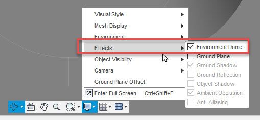

Sorry for that, but i have a small problem and I do not know how to correct it. When I'm using the "Free Orbit" I'm getting this kind of picture. ( the body is sliced in one corner ). Please open the attachment.

It looks like you have the Display Effects  "Environmental Dome" on.  It is really hard to tell from one little picture.  A Screencast would be better.

Yes thank you very much. That was the one. From the other hand, is it possible to make the size of the "Dome" bigger? It is not a "necessary" thing, but good to know. Once again thank you for your help.
