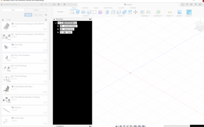

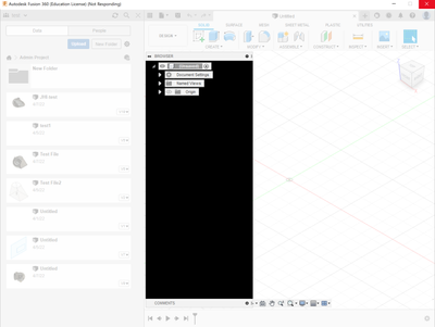

Currently in a school environment.
Issue can be replicated.
Am on latest version  2.0.12670
When on our school WIFI which we have a Palo Alto firewall in place
Autodesk would hang when trying to open a project that is saved in the cloud
When testing it with a hotspot it would work fine.
The network diagnostic test utility that comes built in - passes with flying colour
Can anybody give me some insight into what else needs unblocking?

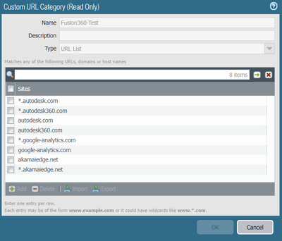

yli8CBAL
Hi Phil, Thanks for getting back to me.
We have put in place all the exclusions required on a test device.
However on the test device it is inconsistently unable to open or save files.
Restarting the device and trying to open/save files,  2/4 times it would hang up.
Tracing with fiddler constantly tells me that  the below two entries are failing with a 502 error.
Stac9.autodesk360.com – a call to SSPI failed, see inner exception
Developer.api.autodesk.com – Authentication failed because the remote party has closed the transport stream
As for *.akamaiedge.net that is a really huge CDN that we ideally would not like to place an exclusion for as we want to be able to inspect the packets that come through.
Is there a more specific subdomain that we can put an exception for?

Message 10 of 12
yli8CBAL
Hi Phil,
Thanks for following up.
I can now consistently get it to fail if I try to open the Appearance tab.
It starts hanging straight away with the same symptom.
Did not manage to reach the material library at all.

We then found a further 4 domains that were still getting decrypted
b.6sc.co
contapi.circuits.io
evergage.com
evgnet.com
However even after adding it to decryption exclusion it seems to be inconsistent
2/4 times it would work fine and the other instances it would just crash when opening/saving or opening appearance.
Then I tried enabling https decryption on Fiddler itself which gave us more insight.
I then whitelisted two more urls
http://com-autodesk-oss-direct-upload.s3-accelerate.amazonaws.com:443
http://www.google-analytics.com:443
But still it was hanging.

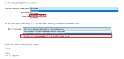

We then set the network proxy setting to the below
1) Windows Default
2) do not warn when accessing through an intermediate server
However it was still hanging
We then decided to whitelist the below domains even though they were not decrypted anyway in a hunch since it had to do with saving/opening /cloud assets.
ec2-52-37-213-209.us-west-2.compute.amazonaws.com
ec2-18-179-18-167.ap-northeast-1.compute.amazonaws.com
ec2-34-201-233-179.compute-1.amazonaws.com
ec2-52-4-99-84.compute-1-amazonaws.com
But it was still crashing.
Eventually we asked the teacher to try
1) No proxy - instead of Windows Default
2) Do not warn when accessing through an intermediate server
And it seemed to have worked.
