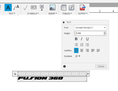

As I tested this on my end,  I found that the font did not show the looks in the Sketch mode although the font type was listed in the Text command window.  However, it showed the looks in the Drawing mode.  Did this font work fine in the Sketch mode as well?

The drawing mode is a workspace to create a 2D drawing from 3D model.  In the workspace, I was able to create texts using "Corrodo Normal" as below screenshot.

I've logged the behavior (regarding Corrado font worked fine in the previous versions of Fusion) with our development team for the further investigation. (internal ID: FUS-42810)  I will get back here once I have something to share!  Thank you for your patience.
At this time using a vector graphical editor such as Inkscape, I would create texts in the font type and converted to outline; then export in SVG to Fusion - the below link would help how to do this:
Getting any Text and SVG file into Fusion 360 to work
Hopefully this helps.
