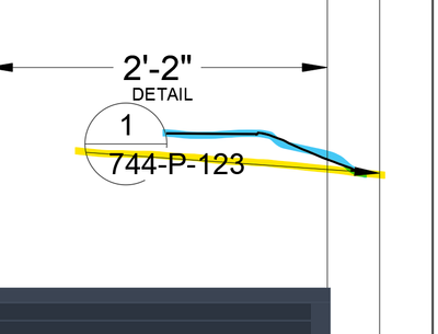

Also now that I think about it, another option to place a fixed point on the symbol for the 'Leader' would also be a welcomed option. On how that might work would be to have a 'leader node' tool in the sketch space to place a point or points where the leader will be attached or can move to depending on where it's placed. In some cases I have a couple of symbols that the leaders can end up in some funky places and it looks weird. In the "Screenshot-081617" highlighted in yellow is how the leader came off the symbol and I drew a line highlighted in blue on how it could have been. Just like with the Text Leader, being able to adjust line so it can break at an angle to get around stuff would be nice.
