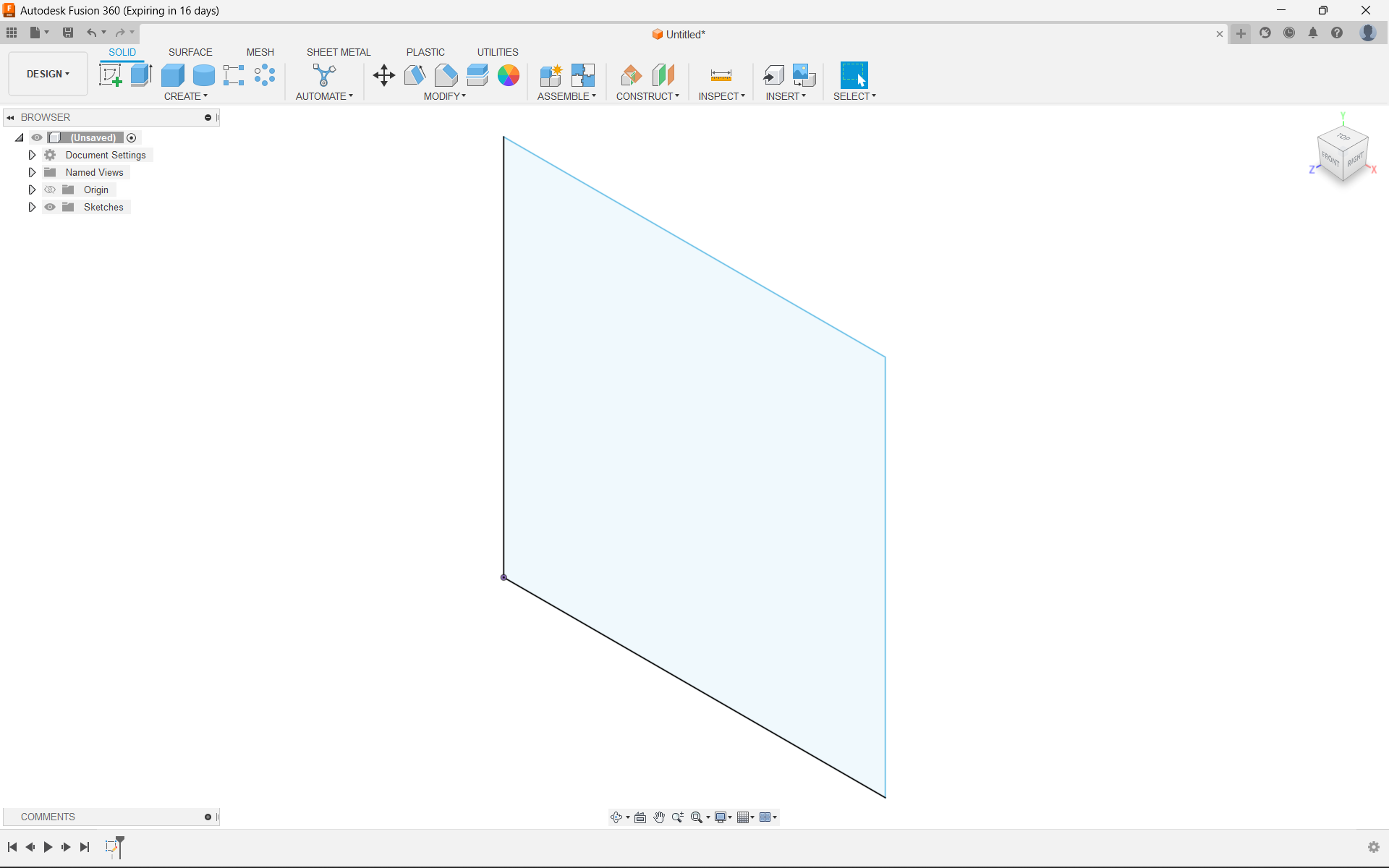

Okay, so here's a rudimentary example:
I could make the final shape by first sketching one face, creating an offset plane, sketching the end face...
Message 11 of 19
14gmathieson
Then creating a loft between the two faces.
Message 12 of 19
14gmathieson
What I would usually do, however, is something along the lines of the following:
Create the side profile in a sketch, extrude it to make a 3D object, and intersecting an identical sketch on the perpendicular axis.
