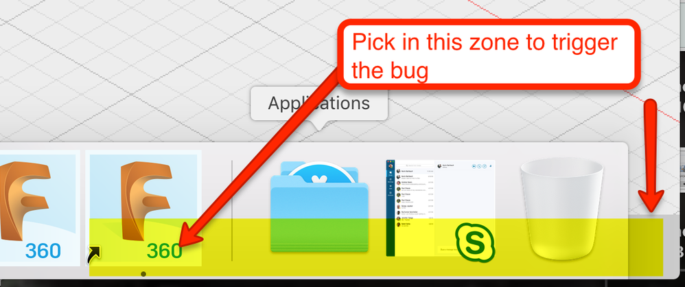

The problem happens when you select the Fusion dock icon with the mouse pointer directly on top of the timeline.
This is particularly frustrating because we tried hard to fix this issue with the information you gave us. It's possible the fix regressed between development and release, or I wasn't testing it correctly.  In any case, we're looking at it as a priority right now to put it to bed once and for all. We have all we need to fix it, and I thank you for that. Sorry for dropping the ball on this one.

Update: We can't fix it by Christmas, but finally we have begun the work updating the component used in Fusion that controls behavior of things in Fusion like the display of the timeline. This effort will take months. Thanks for your continued patience and for reminding me to update this thread.
One thing you can try is dragging the bottom edge of the Fusion window to just above where the dock sits when it appears. That prevents the overlapping effect and thus this issue is prevented. Or you could just not hide the dock. Sorry to only offer workarounds at this point, but for now you can keep it from happening by doing one of these things.

Are you talking about this problem?
If you are, here's an update: We are working on the update that "may" allow us to fix this. It will be released within weeks. That does not mean, however, that this bug is fixed, or that it can be fixed any time soon.
This was the update from just a couple months ago:
"Update: We can't fix it by Christmas, but finally we have begun the work updating the component used in Fusion that controls behavior of things in Fusion like the display of the timeline. This effort will take months. Thanks for your continued patience and for reminding me to update this thread.
One thing you can try is dragging the bottom edge of the Fusion window to just above where the dock sits when it appears. That prevents the overlapping effect and thus this issue is prevented. Or you could just not hide the dock. Sorry to only offer workarounds at this point, but for now you can keep it from happening by doing one of these things."
So while we still consider this a high priority bug, work remains to fix the issue. In the mean time, avoid clicking on the Fusion F in your dock when it sits on top of your timeline. If you do accidentally trigger this effect, simply moving your mouse over the timeline will stop the badness. It's pretty easy to avoid this or break out of it.
