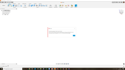

The extrude cut and join functions have been made to glitch.  Cut used to be red and join used to be blue, but now they are both red and blue and sometimes join looks completely red, it's a mess.

TrippyLighting
I can't say that I've seen that in my work.
The reason the cut does not show in red in your screenshot can be found in the error message. It tells you that it can't find anything to cut.

rhetths
The models depicted in my screenshots are readily reproducible even by a beginner.  Create a cube, sketch a 5mm circle on one side, and then extrude in both directions.
There is now another reason why you guys cant reasonably ask for files, because saving to the local and trying to open it often does not work.  I posted about this on this forum but got no response.  Refer screenshot below.
Plus, Fusion is currently offline, which shuts down all reliable access to my files and thus my design and manufacturing.  Refer screenshot below.
Fusion has become diabolically unsuitable for business use.  A shambles.
