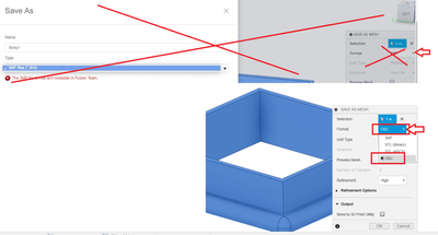

I tried to save as mesh but comes up with this error ( attached ) . I attached you also the .f3d file.
TheCADWhisperer
@kiourtsidianna
Why are you trying to save as 3MF rather than as OBJ???
Click on image above to enlarge the view.
