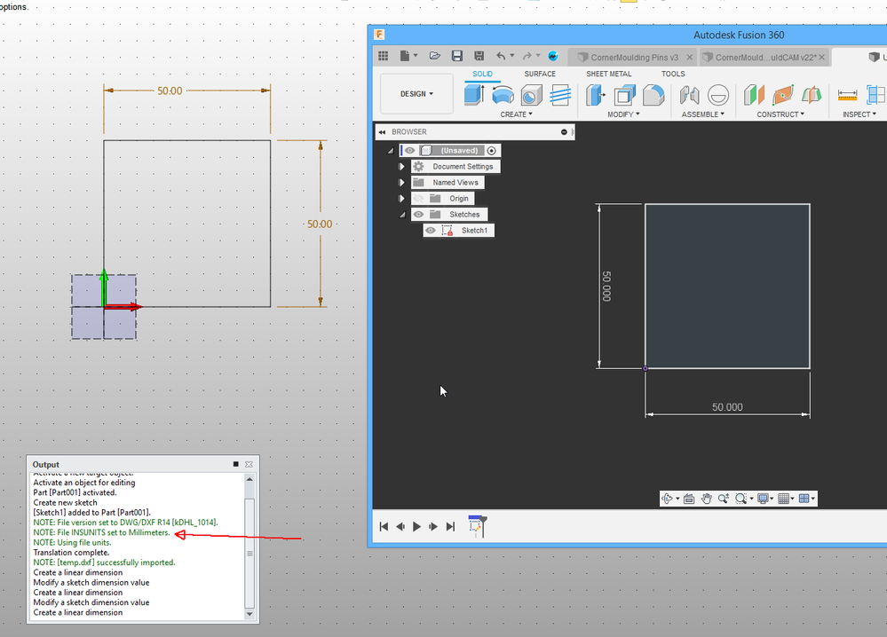

HughesTooling
@Anonymous wrote:
This isn't at all solved for me.
Which ever method I use to export DXFs, either directly from the sketch or from drawings, the scale is completely skewed when opening the DXF in any third party software (have tried 5 different packages all showing the same skewed results).
I'm utterly blown away that this is an issue. And one that there seems to be no response for. How can that even be possible for such a critical component of the software? What is the point of having all of this amazing design power if you can't send files to machines to get cut at the right size?
Mind blowing. Never had this issue with Solidworks.
How are Autodesk supposed to fix a third party's program that isn't reading the DXF correctly? Here is what I get exporting a DXF to ZW3d. As you can see ZW3d reads the unit info and scales the sketch correctly. Your mention of Solidworks is quite funny as they don't actually set the unit info correctly in their files, they only set the $Measurement variable to either 0 for English or 1 for Metric but English what inches, feet, yards, miles?! Fusion's DXF files are correct so you need to report the bug to the third party developers and point them to this document,  page 47 might help.
