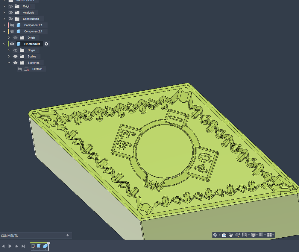

jlarkin
Hi looking to create an electrode from this model for a test with Orbiting I tried to mirror the face but it only reversed the letter not the form will Fusion do this

Message 12 of 17
jlarkin
the part is what I sent I need the entire face form reversed on to an electrode so I can create the cut path for a Mill

Message 16 of 17
jlarkin
That profile is the same as the punch see pic above that is what the electrode should look like
Message 17 of 17
jlarkin
sorry for any confusion this is what I was looking to get
