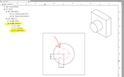

When creating a drawing for a component in the model, I need to added geometry via a sketch to aid in manual machining at 45deg angles.  In this model, drawing DrawingError shows two dimensions with warnings. The dimensions reported by Fusion is WAY off and cannot be trusted.  Unknown where these dimensions are coming from but dimensions using added sketch geometry is NOT reliable.

The dimensions with warnings are pulling from the sketch that you added in the drawing environment, and not the model itself (two different scales).
I hid the drawing sketch (sketch 3) and re-associated the dimension, and it looks to be correct now.
Best practice is to create the sketch within the model itself (instead of within the drawing environment) if you need to reference it in your drawing.
Edit: Just to illustrate the point, change your model scale from "3" to "1", and you should immediately recognize the issue.

Yes, you can display the sketches made in the Design environment onto your drawing. After you place a view, just navigate through the browser tree to the component that the sketch was built under, and then toggle visibility both for the "sketches" folder, and the specific sketch that you want to show. You can also change how the sketch looks via "Document Settings" (color, line type, width).
I won't comment on the utility or purpose of the Drawing Sketch function, as I haven't found a legitimate use for it. My guess is it's tied to the scale of the physical sheet size, and not the component views, which causes the discrepancies. Other issue is the Drawing Sketch isn't constrained to the views, so if you create a sketch and then move the view, the alignment will be off. This is where building the sketches within the Design environment come into play, as it maintains the association with your actual model. Same idea as creating joints to assemble components vs. using the "move" function to locate.
