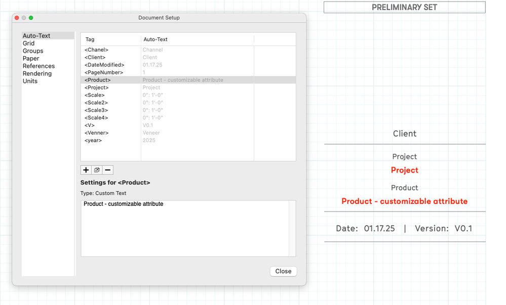

Hello!
This is my first time posting here. I have been using Fusion for several years but have never really used the drawing side of it.
The company I work for uses Sketchup Layout for drawings and the constant importing/exporting of files is something that bothers me and slows down my workflow.
I was wondering if Fusion has the ability to create auto-text similar to that of Sketchup Layout. I know it has "custom attributes" but I am unsure how best to utilize those.
In addition, I was wondering if its possible to have multiple custom attributes on a single text line, for example, having a text box with "<Product> - <Project> - <Version>" all together?
Below I have an example of a template my company uses for SKP Layout. It has a lot of autotext that allows for a great template that can be used for any product drawing. So you just replace the text in the document setup and it auto populates throughout the drawing set.

I was wondering if there is the ability for it to auto populate multiple locations if they are using the same attribute.
For example, if I have "<Product>" in four locations on a single page, is there a way for me to change one and have them all switch to the new text? Or would I just have to switch all of them manually?
Thanks!
-KyleWilliams-
At the moment it is not able to "link" custom attributes together by name and these need to be done manually.
