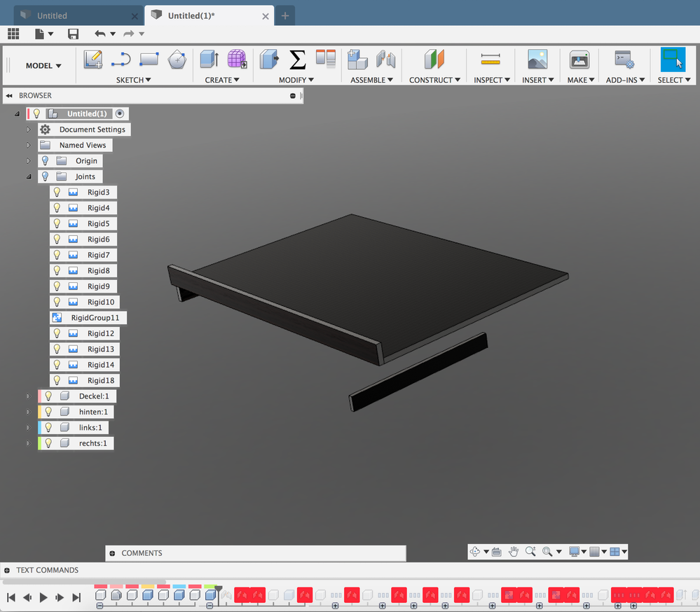

I am linking in this thread on the German Fusion 360 forum.
The user seems to have several problems with the design (there's another thread). One of the problems is that a Modify->Compute all creates a host of joint errors when it should not.
Pulling back the timeline to before the occurrence of the first joint should usually remove all joints from the browser tree. However, that is not the case. So the question is how can a design get into desolate this state ?

Thanks for posting this, @TrippyLighting.  We are actively looking at an issue, which seems to be similar, from this thread:  mirror-components-missing-instances.  This extra data is helpful to that investigation
