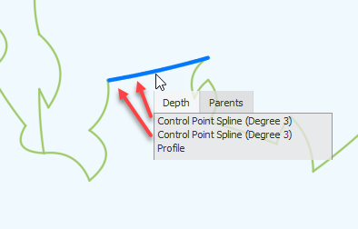

when I'm cleaning up an svg file before extruding I have to hit the delete tool twice to remove a line.
then it will start working for a few minutes and I only have to hit the delete tool once.
the select tool for lines you want to remove behaves the same way. I'll select a few lines, hit delete and it may delete some or none at all.
am I doing something wrong?

g-andresen
@gdcm1964  schrieb:
... I have to hit the delete tool twice to remove a line.
This is what happens when two identical vectors overlap.
günther

TheCADWhisperer
@gdcm1964 wrote:
this is one of the svg files I was cleaning up.
@gdcm1964
Whatever technique you are using to create that it is creating duplicate curves over top of each other - that is why you have to delete twice when single selection.
To get both spline curves at the same time use crossing window selection (Right to Left).
Crossing window selection.
