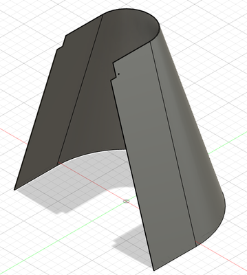

This is my skelet, and I want to masuch sheetmetal around:
This one i have tried to create as sheetmetal, but I cannot make (screw)holes patterns in it or unfold. I think I have made it the wrong way.

g-andresen
1. create a revolve cone surface  from single  line
2. thicken to 2 mm
3. extrude both sides to 155mm
4. convert to sheet metal body
5. Modify > unfold
6. project body into sketch and add cut out and hole profile
7. unfold
8. create flat pattern for production
(view in My Videos)

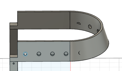

I have to have the sheetmetal folded to be able to make holes through both sheetmetal and brackets behind. I can make one hole (skecth on outer metal side) - all fine. But when I then make a pattern around the edge, it is only the bracket behind which gets the holes - not the sheetmetal. Why can that be?

joaM7CEC
The hole even do not look like the same on the frame/holder.

Only the big curved plate is sheetmetal. Therefore I need to have all holes marked and aligned before I start produsing any parts. The inner parts which hold the "sheetmetal-outer-cone", will be 3D-printed. I cannot drill holes afterwards.

I'm still puzzeld why the holes only are copied in the round bracket, and not in the sheetmatal cover. Even if the sheetmetal is the origien and the first hole is perfect.
