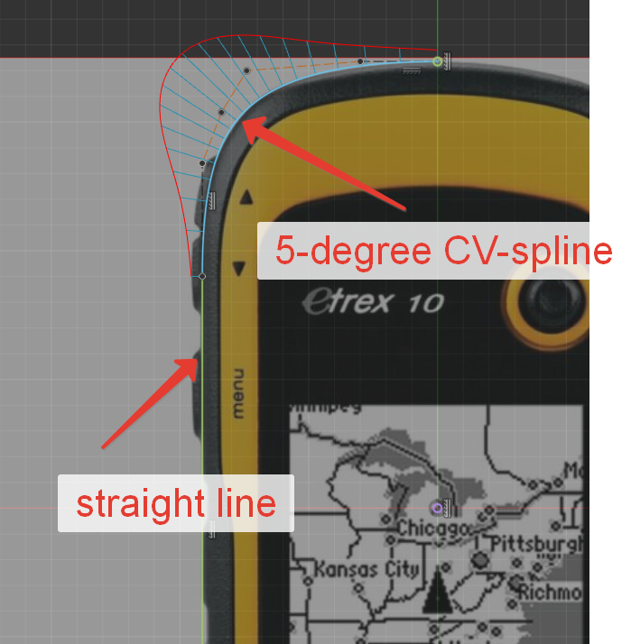

I'd stick with following approach
1. Get primary shape of your device without any recesses, buttons, etc.
This could be done either with surface modeling or t-spline sculpting, it depends on how your device looks like from other sides (has no garmin near to reference).
2. Add more details as you move on.
If you choose surface modeling to get your primary shape you should not use any imported svg/dxf. Draw that in sketch itself using canvas as a reference and try to make as simple sketch as you can. Use lines, arcs, and CV-splines (control point splines) with as little points as you can. Like this
This sketch has only 2 primitives - straight line and 5-degree CV-spline to resemble part of device shape.
