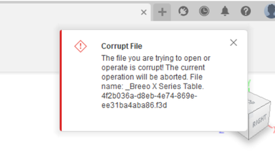

I have a design file that became corrupt. It was edited and worked fine on Thursday, Fusion and the computer were shut down for the weekend and on Monday the file was corrupted and would not open.
However, it opens just fine on my partner's computer.
I am on build 2.0.13619 and he is on 2.0.13162
These are the errors I am getting.
Can anybody give me some direction here?
I have tried uninstalling and reinstalling Fusion. I have tried saving the file from the cache and opening it that way. I have tried opening off of the Team home page. I have tried deleting the project files out of the cache. None of these have worked but it opens perfectly on my partner's computer.

It will not solve your problem of opening the file on your computer but if you partner can open it, why not have them export it and send it to you via some transfer source.  Then you can simply replace your corrupt one and move on?

Thank you for your reply. He did email me the file from his computer. I shut down my Fusion and opened his file directly from the email with the same result. Should I be saving the file in some manner before opening or what exactly are you referring to by replacing it?

So your partner opened the file in Fusion 360, selected the File menu, then Export and save the file to their hard drive.  He then emailed it to you.  You then saved it to your hard drive and then tried to use the Open command to open it from your local drive and it will not open?  If you can, attach this file to your Forum question and see if can be opened by someone on the Forum.  The method I described above is one way we all share Fusion 360 files.  I would also make sure you are both using the same Fusion 360 version.

I have a file that generates a corrupt file error and will not open on my workstation with the latest build 2.0.13619 but opens fine on my partner's workstation which has a much older build(see original post). The file was last used successfully on 7/14 and the next time that I attempted to open it was 7/18 at which time it returned the corrupt error code.
@jeff_strater @Phil.E  Can I send you the file to take a look at or what do you suggest that I try at this point? I have tried reinstalling fusion, exporting the file, deleting the cache, etc.
