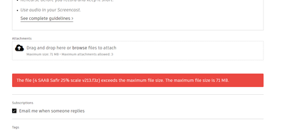

kvlasblomQYQWD
Thank you so much for your help. I am embarrassed about the mistakes in the file. Sorry about that.
I know I messed up there.  I tried to attach the file but it exceeds the limit. Can I send it another way?
