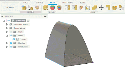

How to converts a brep body to mesh in fusion 360 ? Anyone help me with is please. ( It was there before, but this option is not in the menu now. i guess it was change after an update.) These reference image I have attached, Showed that this particular option was there in the menu once, but now it's gone. Or may be I don't know where it now.

Take a look in the Mesh tab\workspace.

try this

thank you so much
than you
