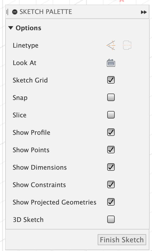

jeff_strater
I'm not sure what the "constraint popup" is, but if you are looking at old videos, you might be referring to the fact that the constraint tools used to be on the sketch palette:
Those tools are now in the sketch tab on the toolbar:
and will appear only when you are editing  a sketch.

For example If I click on the Symmetry tool there should be a small popup window allowing me to chose between the actual parts I want to be symmetric and the middle line. That does not appear.
