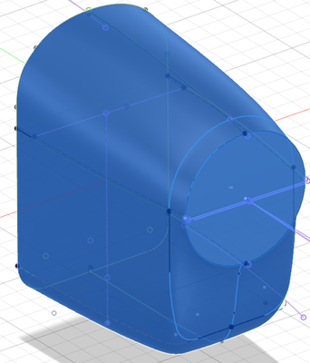

I'm completely new to Fusion 360 and 3D CAD in general. I'm trying to build a cowl for my RC plane. I've built out the fuselage, engine, and nose cone in enough detail to model the cowl.
The problem I'm running into is when I try to do the loft function with 2x rails I get a twisting function on one side of the cowl and it unnecessarily bulges out on the bottom of the cowl instead of following the rail.
- If I do the main body of the cowl and the front section separately then it seems to come out ok, but with less blending between the 2 parts.
- I am able to sort of straighten out the twist on the left side by moving the control lines, but it's not ideal and increases the bulge at the bottom.
Of note, both sides of the cowl are NOT symmetrical and this might be causing the problem.
- Attached pictures are what the old cowl looks like and the model I'm working with...yes I'm aware that the sketches are not constrained and there are likely many issues with it.

Update: Getting closer. I redid the entire thing from scratch cutting out 2 of the intermediate planes and focusing more on aligning points between the front and back sketches. Then I used more rails to define transitions between the spinner in front to the fuselage in back.
Seems Fusion likes rails more than intermediate planes. I'll post the finished when complete.
Message 3 of 11
L_Stanford
Ok, this is about as close as I can get. Added an intermediate plane back in and kept adjusting side length to push the intake area flatter. I'm fairly happy with this and can't wait to print it!

If it were my design I would attempt to eliminate most Loft geometry and instead use Revolve or Extrude for the basic parts of the geometry.
Message 5 of 11
L_Stanford
@TheCADWhisperer That was my next step, revolve the cylinder top and make a block for the bottom, fillet front edges, and join. I might still try it just to work on my understanding of Fusion.

Gents, was able to work it out. I already did a test 3D print and it came out pretty good. Need to make some adjustments for the exhaust screws and air/fuel mix valve, but otherwise I'm pretty happy with it.
