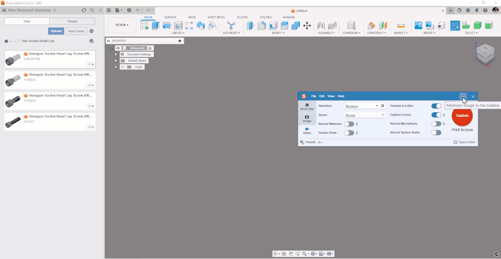

Method 1:
Insert -> Insert Fastener ->  Select Bolts and Screws -> Socket Head -> Hex Socket Head Cap Screw (ANSI B18.3-2003) Then select these Parameters:  7/16, 1.000in, UNF (20 pitch) and THEN edit the part number and/or description names to change the "x 1" at the end to be "x 1.125",  and finally place screw.  THEN I go to Fasteners in the design tree and break link for these two fasteners that I just placed.
Before even editing or doing anything else, the problem with this sequence is if I now select this same screw from the Insert Fastener function (in this design or any other) it has "x 1.125" for the "x 1.000" fastener in it's part number and description.  So this isn't good.  Scrap this and try....
Method 2:
Insert -> Insert Fastener ->  Select Bolts and Screws -> Socket Head -> Hex Socket Head Cap Screw (ANSI B18.3-2003) Then select these Parameters:  7/16, 1.000in, UNF (20 pitch) and THEN place screw.  THEN I go to Fasteners in the design tree and break link for these two fasteners that I just placed.
Ok, the fasteners now automatically move themselves from the Fasteners folder to be 2 separate parts in the normal (lower part of) design tree.  That's fine I guess.  I would rather be able to create a new fastener in my fastener library that I can use later, but one issue at a time.
But now for those new screws in my design tree  "Open" and/or "Edit in Place" are not options when I right-click on these parts now, not sure why that is...    It turns out I can however edit the sketches of the fastener.  It also turns out that when editing the design BEFORE breaking the link, the length was the first Parameter in the list (named adsk_nomlen).  After breaking the link apparently a whole new set of the same parameters are copied N times per instance of screw, so for the first screw, the length is now a new parameter called adsk_nomlen_2 further down in the list.  And for the second screw the length parameter is even further down called adsk_nomlen_3.
Also, I can edit the fastener name in the design tree, just like any other part and fix the length in the name there.  However, if I look at the Properties for each of these items the Part Number and Description are the old (incorrect) name with "x 1" in the name 😞
So I now have a model that has the correct length fasteners with odd identifying information associated with them.
Before the new Fastener Library feature I had been accumulating (from Insert McMaster-Carr Component) screws that I use in a separate project.  When I use those, I have to place in current design and create a Joint.  I like the (relatively) easy lookup and placement of the new Insert Fastener function, but if it doesn't contain the length screws I need, or or is missing screws I need (there are NO set screws in the fastener library, for example) then I need to jump through these hoops to use it.
Seems like this feature should have been a Preview feature or optionally turned on/off since it is currently half-baked.  The last thing I need is inconsistency in my designs so I have to spend time trying to figure out where/what screws are in a design, what they are called etc.  Am I off-base and missing something here?
-Tom

I like your method, and I'd click accept but I have one issue where it doesn't behave as in your video.  I have deleted all uses of this screw (the 7/16-20 SHCS 1") from my designs, and I have removed this screw from the Fasteners folder.  I have killed and restarted Fusion and verified the fastener is not in my fastener library and not in any designs or drawings.
Now, when I insert one of these, then break the link, then activate it, and finally go to Modify -> Parameters, there are now 4 sets of parameters (see screenshot) and I have to figure out which one actually changes the length of the screw.  At this time it is the 4th (last) set.  Not sure what is going on.  It's as if every time I break the link Fusion saves a new set of parameters for that screw or something...?   This isn't a show stopper but changing multiple entries and watching to see which one ACTUALLY changes the length is annoying.
