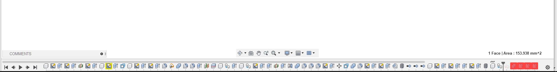

My current project has some features in the timeline that I can't find a way to delete. These features pertain to a body which I have removed from the project. They now appear in the timeline with a red bar across them (see attached screen capture). In the past, I've been able to simply click on a feature to delete it, but the features that are highlighted in red cannot no longer be selected for any action. Any suggestions?

@Anonymous - can you share the model?  You should be able to delete these features even if they are to the right of the end of design marker...

Thanks for sharing the design, @fapalmeri .  That is very strange, all right.  I've never seen that before - where a feature just cannot be selected at all.  I was able to get around it by rolling back past one valid feature, then the "Delete all Features After History Marker" command will get rid of those features.  You'd have to re-create the last valid feature, though.  We will investigate this further.
