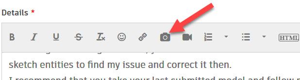

I would like to mention something about you saying you could not attach more than three items.  This is true but you should not be attaching screen captures at all, they should be embedded in your post.  That is what the indicated icon will do for you.  In the screen capture below, it is not attached, it is embedded in my message.  The attachment feature is for adding your model and other types of non-image files.
