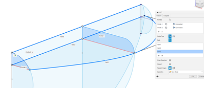

Hi! I have a problem, I want to loft a body, it's quite complex, but I can't, I keep getting errors.
I will post photos of the object I want to model, but it's not the same, I have other dimensions because I want to make it more compact.

davebYYPCU
Not enough control of the shape in those sketches.
Make a sketch on ZY Plane, connect the shape at this location  using Project > Intersect for the 4 points to connect to.
When you do that, still won’t work, because 2 sketches have sharp points.
Circle can’t loft to the horizontal sketch, if the corner is aligning with the same plane.
Use Surface Loft, and small sections at a time.
Might help….

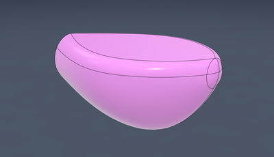

TrippyLighting
How's this for a start?
Message 4 of 11
nectarietotan
That's very nice looking, like what I wanted, how did you do this?
Message 5 of 11
TrippyLighting
I attached a model to my last post. If you step through the timeline, you should be able to see how this was modeled.

nectarietotan
Thank you for your help till this point, I still have a problem, I tried @TrippyLighting method using the timeline from the 3d model he provided, and it worked, but I don't get an exactly nice shape when doing the fillet, I don't quite get continuation for the first face/profile. I divided the upper body by the second face/profile and then tried to loft the upper section of the first face/profile and the newly divided section, but the loft is not nicely executed.....What should I do?

Message 10 of 11
TrippyLighting
The sketch inputs you have created don't lend themselves to a fillet.
I used a surface modeling approach and simply had to guess what you're after.
If you want to actually make a physical artifact, then would strongly recommend that you use a caliper to measure key dimensions and then fully constrain and dimension your sketches!

Message 11 of 11
nectarietotan
Thank you so much! I didn't know I could use surface modelling, I only worked with solid, you did exactly what I wanted to do!
