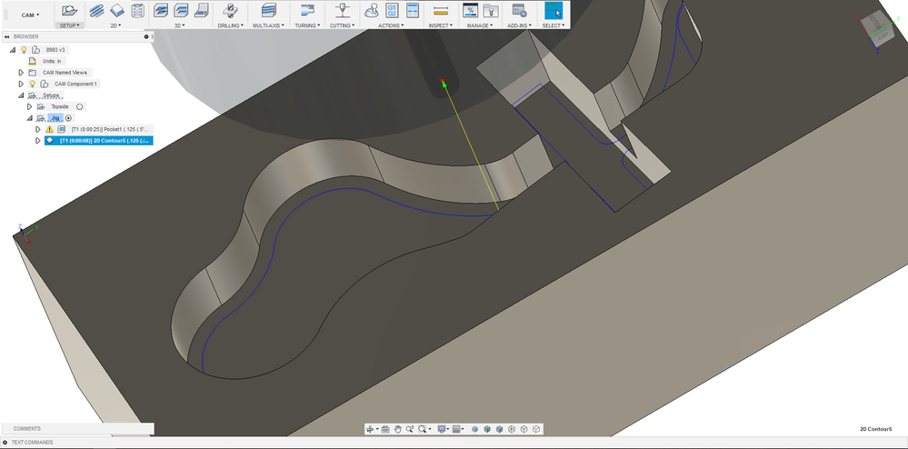

I noticed a weird bug with the displayed setup origin in CAM, When in the center of the display area it is in the correct location on the model/stock:OriginError1.png
it shrinks and shifts from its correct location, it doesn't display this bug when to the bottom or to the right of the display area, it merely disappears.
I can't be certain that this is new (this could be a known bug) but doing a quick search didn't show anyone reporting this issue, however I haven't noticed it before.
Hopefully this helps the flyswatters target any bugs that are showing up in the latest version Smiley Happy
Tim

Hi @Anonymous
Thanks for posting! I was able to recreate this in some new files and have logged CAM-10960 with the development team to address. We appreciate you reaching out!
I believe this is a graphics/cosmetic issue and it should not effect the toolpath generation or output in any way, but please let me know if you see any unexpected behavior that seems related.
