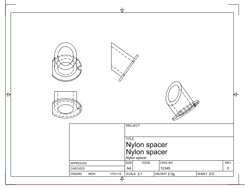

@g-andresen  QCad does have some problems reading some of fusion's splines. I can't use QCad anymore as I've run it 100 times so now it will not even work as a viewer. Not going to buy as I have Rhino but it was useful to point other users to QCad.
Anyway here's an example of a simplified DWG export in Rhino. Comes is nice and clean, all simple lines, acrs and ellipses.

Just out of curiosity I made a part with a fit point and control point spline, created a drawing and exported as a DXF then opened in Rhino.
All looks good to me. The fit point spline comes in as a degree 5 spline and the control point as a 3.
