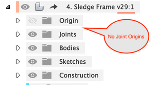

This bite me again, today. I'll place some pictures here, but just wanting to get a knowledge that is being worked on (it's been in the oven for 8 months, now).
Inner projectInner project
I find this bug and the delay fixing it hard to understand. The Joint Origins are intended to make connecting components easier. The Derive feature is intended to make distribution of components easier. Surely these two should play together?
Workaround: I make a sketch in the inner project (since sketches do survive the Derive) and either create the Joint Origins in the parent side (whoa! bad modularisation!) or join directly to the sketch.
