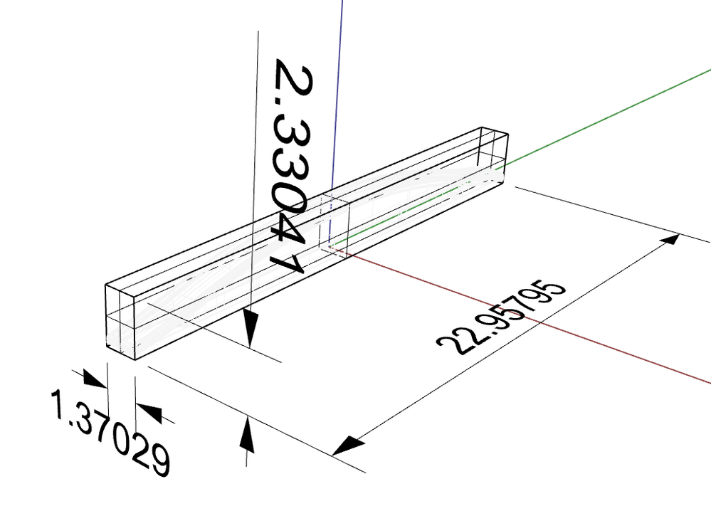

Good Morning,
I've noticed a disconnect between the bounding box sizes that are posted in the component Property dialogue box, and the "bounding box" that is generated in a CAM set up dictating zero stock on all sides.  This appears to happen mostly on organic shapes as I've seen this issue repeat itself on multiple occasions.  Please see attached photos and please let me know if there is something I'm missing.  The bounding box in the Property dialogue is an extremely useful tool, however, as it is now, it's unreliable.
Thank you for your time.
Best Regards,

Yes definitely something wrong with the bounding box in the model workspace. Pretty sure the bounding box is calculated off a mesh so probably it's not fine enough. @jeff_strater  What do you think.
Rhino returns this.
I've attached a python script that will create a sketch in the root directory. The script was a demo I found somewhere a while ago, I've set the mesh tolerance to 0.00001cm. Still a small error but a lot closer. Info here on adding a script.

Thank you for the feedback!
I added the script/add-in per the instructions via the link he attached.  The bounding box that is now created is a lot more accurate than the box outputted in the Property dialogue box.  Thank you for the assistance with this!
Would you happen to know if/where there may be a shortcut, or if this function is in a drop down menu somewhere?  As of right now, the only way to create a bounding box would be to go to Tools/Add-ins/Bounding Box, and then click on RUN.  I can most definitely navigate thru these steps, but I was just wondering if there is a quicker means of activating it.
