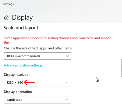

Hi all,
After the latest April update - it has come to our attention that when clicking on command menus such as Create, Modify etc, the menu is opening upwards and off the screen.
We have determined the root cause and are working on fixing it ASAP! I will post back here with an update when we push the fix live. Right now the menu opens upward if it cannot open its full length downward, rather than centering in the screen. Generally this is causing by excessive display scaling, or by having the screen resolution set to a height that is smaller than the menu needs to open normally.
To workaround this issue, while we fix this (Fusion 360 Can Remain Open):
  1. In the Windows start menu, search Display Settings and select the Display Settings
  2. Change ONE of the following options and test inside Fusion after saving the setting:
    • Under Display Settings, turn down the display scaling (try 100% and work your way up with testing - depending on how scaled it needs to be readable for you)
    • Change the resolution to have a height greater than 900 as shown in the screenshot below
  3. Save your settings when you find one that works
Let me know if you have any questions or need help. A screenshot of your Display Settings would be most helpful in diagnosing this if you still need help.
I know this can be frustrating but one helpful tip - hit the 'S' key in Fusion 360 to bring up your Modeling toolbox which you can type and find any command you are looking for. Also, I will update this thread as SOON as I have more information.

durock75
Hi Guys!
I solved the problem like that on my notebook.
Display Resolution 1920 x 1080
and the most important Scale Layout reduce to 125%.
I hope this setting could help you.
Thank you
