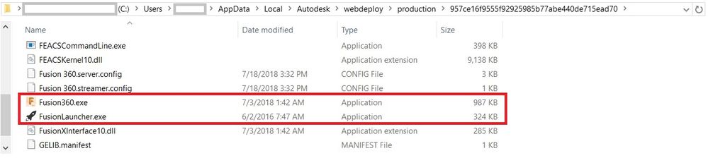

I am attempting to allow Fusion to go through my firewall in an effort to improve performance and stability.  I have been trying to follow the following instructions:
Firewall Settings
1. Browse to Control Panel\All Control Panel Items\Windows Firewall and select Allow a program or feature through Windows Firewall
2. Select the Allow another program
3. Select Browse and select the following .exe files and add them to the list
%LOCALAPPDATA%\Autodesk\webdeploy\production\<ID>\Fusion360.exe
%LOCALAPPDATA%\Autodesk\webdeploy\production\<ID>\Win64\AdCefWebBrowser.exe
Which are from a Forum post.  My problem is that I can not find the files indicated on my computer using File Explorer.  Have these file names changed or is there some trick to finding them?

Hello @s.david.baxter,
thanks for posting! This is the correct way to configure the firewall to allow Fusion 360 to run correctly. The default directories should not have been changed.
You might first try to go to %localappdata%\Autodesk\webdeploy\production (or C:\Users\<USERNAME>\AppData\Local\Autodesk\webdeploy\production) and enter both directories that are stored there (their names contain a sequence of letters and numbers). One of them should contain both the file Fusion360.exe and the directory "WIN64". The other contains "FusionLauncher.exe".

Thanks for your reply. I was able to find and add file
"6a0c9611291d45bb9226980209917c3d" successfully through the firewall.
Using the same tree structure as in the above file leads me to the second
file (with an even longer name). However, this is also file folder which
leads to more files. Can you please provide the full file structure tree
to allow me to navigate to the correct second file.

thanks for getting back to me! The files you are looking for should be located here:
AdCefWebBrowser.exeAdCefWebBrowser.exeFusion360.exeFusion360.exe

Yes I did find them, what was missing from the original communication was
the Win64 directory. Once I had that the rest was easy and now Fusion can
bypass the firewall. Will this make a difference in performance or
