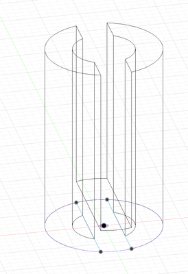

OK, let's say I've got a component like this: (F3D Attached)

OK. Now I want to place it so that it's passing, centered horizontally, through the slot in the tower, with the threads lying on the bottom, and with the head up against the outside edge of the Tower. I want something that might look like this (but this was done by hand, not with help from Fusion). Top view:

OK, so obviously I can get to this situation with manual moves, but if I do it by hand, the alignment won't be perfect. This will make as-built joints (based on the non-exact, by-hand placement) problematic. Eventually, the goal is to have the screw move up and down within the slot in the tower.
I have tried numerous incantations of the Align tool, as well as Joints and Constraints. I can follow-up and add a bunch of videos if that would help show what I've already tried, but suffice it to say, nothing I've come across so far has even come close to doing what I want.
I want to:
* Align the inside face of the cap screw to the outside face of the tower.
* Align the outside of the threads on the cap screw to the crossbar at the bottom of the tower.
* Align the long-way center of the cap screw to the horizontal center of crossbar at the bottom of the tower.

leaving the basic positioning question for later (or maybe someone else will get there first.  The answer is probably to use a Joint Origin), but I want to comment on this:
"I have been told multiple times that using Joints or Constraints is, for some unstated reason, superior to Align/Moving parts into place before creating Joints (or, more specifically, As-Built Joints), but I've never read a good explanation for why."
I can answer that very simply. Joints (or constraints) are better because they directly reference component geometry.  So, if that geometry changes, the Joint will still solve correctly.  Align (or Move) of components, followed by an As-Built Joint (or Rigid Group - they are the same thing) is not parametric to the referenced geometry.  So, if the geometry changes (cylinders get bigger/longer, etc), neither an Align nor the subsequent As-Built Joint will update correctly.  I will record a quick video to illustrate.

Sketch2 in your Tower Component not fully defined.
Edit: Oops, I made a mistake but you should be able to now figure out the solution from my example.
Post back if you can't figure out how to change the constraint to remove the interference.
Note that the head of the fastener against the tower must be two different positions when it gets to the end of the slot where the cylinder material is not missing.

and, here is how I would use Joints to position your two components.  Joint Origins allow detailed level of control that allows me to define a location (which is also associative to the selected geometry) to position the components as I need to.  The Joint command, then, allows you to choose the axis along which motion happens (in this case, a slider)
