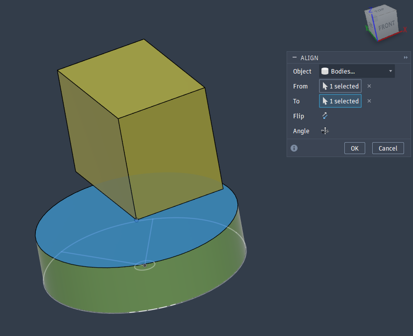

Rotate is available if you're aligning a component but not a body. Don't know if it's always worked like that as it's not a tool I use. For components I'd always use a joint because you should try to avoid capture positions in the timeline as they are not as efficient as joints.

Have you got an old design where you used align on a body with rotation? What happens if you try editing the align now, does it show the rotation or reset the align and remove the rotation?
OK, Something weird. After playing around aligning components I switched back to bodies and now I have the rotate option of bodies!

After restarting Fusion Align gives me the option to rotate bodies so not sure what was up before?

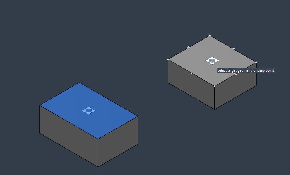

@grahmart It seems to work OK for me now. The only time I see it not give the rotate option is if you select a face rather than one of the points on a face.
If I pick two point like this it works but if by mistake you select the face for one of the selection you don't get the rotate option.
EDIT. The same goes for aligning to the origin, you have to make sure you get the square target around the origin point and a point on the body's face.
