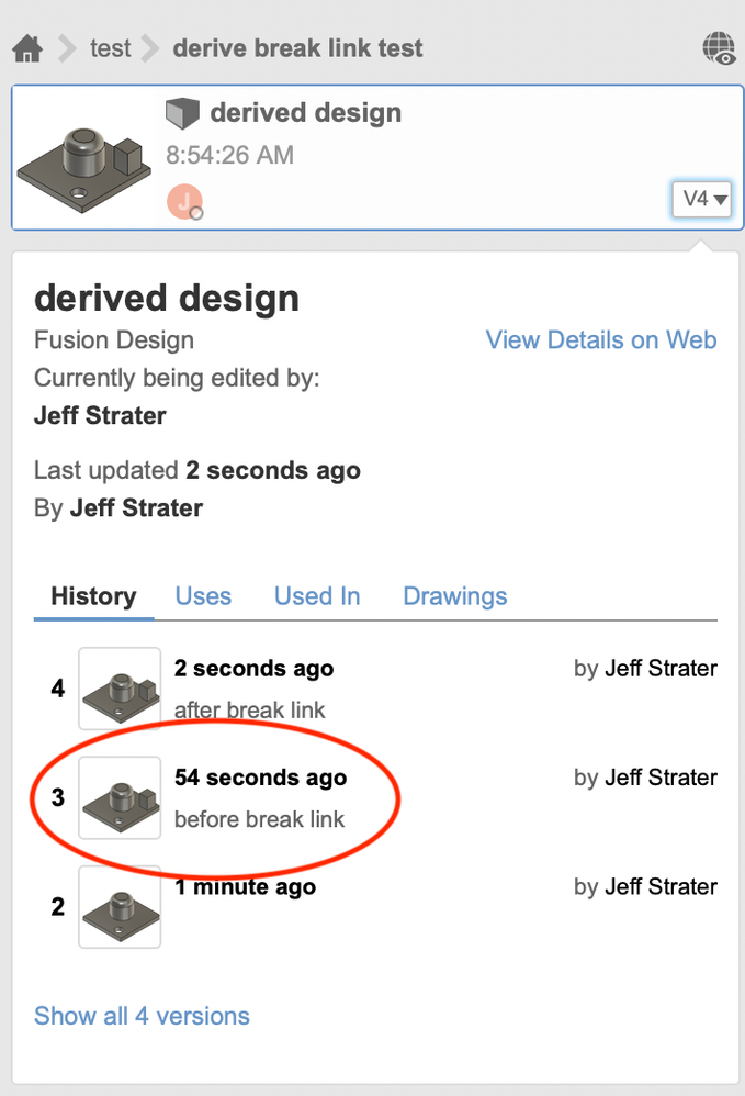

jeff_strater
@cem.yavuz wrote:
But, when I break the link all useful information(file name, version etc.) about the original source file is lost.
This is what Break Link does - it breaks the link between the Derived design and its original.  I understand what you want, but that is just not the way Break Link works, and it is unlikely to ever change, in all honesty.
However, what you can do is this:  If you save a version of your Derived design just before you Break Link with the source, and give it a descriptive comment, that version will be preserved in history:
You can directly open old versions of designs:
