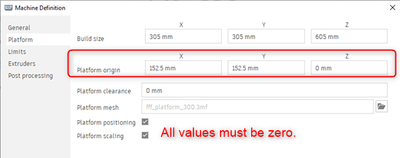

Hi all,
I'm new to fusion so i may be missing something obvious but when i prepare my model for additive manufacturing in fusion the model is placed on the build plate and there looks like an origin symbol in the middle of the build plate, but on my machine the origin is front left corner......so, when inpost process it, the actual model tries to print off the bed, in the gcode view it is also offset this way. Can i specify my 3d printer's origin anywhere in fusion? as i cannot use it this way.

Hello @dorrington476
Apparently we have made a mistake in the offset definition only on this printer. The other Raise3D are ok.
I will fix the definition in the library
As the library is updated weekly, it won't be available this week..
But in the meantime, you can copy the machine file in a personal folder and edit it.
Sorry for the inconvenience.

For everybody's information, the online library does contain the fixed version now.
