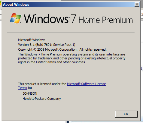

Thanks for sending the screenshots over via email. The fact that one Windows update fails to complete could be related to the problems you are experiencing - I would recommend reaching out to Windows to see why this update is failing. It may be that we need to force the Windows updates to complete in order to resolve this issue. This link may be a good starting point for troubleshooting Windows, but you may need to get in touch with their support team if problems continue.
The screenshots did not show the current build of Windows 7 you are using - would you mind sending me the build number for the updates that have completed? You can post this on the forum and should be able to gather it using this procedure.
I would also be curious to know if Fusion runs properly if you create a new Windows user profile (with Admin permissions) on the system and right-click Fusion 360 and select "Run as Administrator" when launching the program.

I have 4 screen snips. Whats strange is number 4 which shows no updates even tho I did the windows update. Also, Fusion360 still fails on entry to drawing mode running as administrater from a new user profile??
