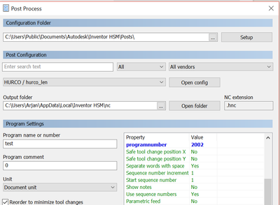

Very good @lenny_1962. Nice to see that you got this far. The number and name works here with the pasted code
PropertiesPropertiesFilename and numberFilename and number
lenny_1962
I've pasted it in and get errors or no fields in the property box when posting.
can you give me a screen shoot of what yours looks like, maybe i'm not getting errors do to the pasting???
or have you added something else to the property lines in the post?
ArjanDijk
Sorry, missed one dash, try this:
 if (programName) {
var programId;
try {
programId = getAsInt(properties.programnumber);
} catch(e) {
error(localize("Program name must be a number."));
return;
if (!((programId >= 1) && (programId <= 9999))) {
error(localize("Program number is out of range."));
var oFormat = createFormat({width:4, zeropad:true, decimals:0});
writeln(
"O" + oFormat.format(programId) +
conditional(programComment, " " + formatComment(programComment))
} else {
error(localize("Program name has not been specified."));
return;
