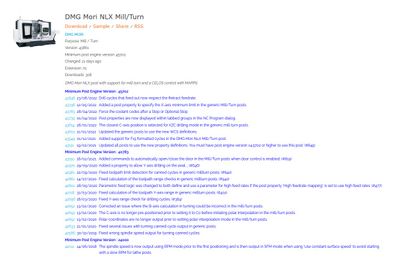

Only PP I could find that might be a starting point for you is the DMG MORI NLX MillTurn, Post Processor .cps file attached. This is the latest version, only 21 days old 🙂
If you don`t have it here is the link to the PP Library :-  https://cam.autodesk.com/hsmposts?
