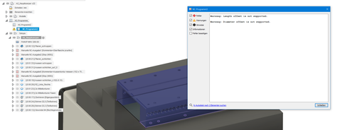

Hello!
Finally after a year I managed to convince boss to buy Fusion 360 license, because we were only making programs with Sinumerik itself. Previously I was using postprocessor for Haas NGC, but now I'm trying to make it work with Sinumerik. Our machines (two 3 axis mills) have Sinumerik 840d sl software, so I used postprocessor for 840d.
1.) However whenever I'm postig G-Code, I get warnings:
Warning: Length offset is not supported
Warning: Diameter offset is not supported
Somehow I managed to get rid of second one at home, but I don't remember how I did it. And there still is first warning, that I can't fix.

hello folks,
same here, using Sinumerik 840 Post for an 3 Axis Machine and after the update yesterday (liveupdate hotfix)  we get this Warnings every post run .
hope you can help

I am using standard Sinumerik 840d post in Fusion own library.
By accident I found post about it in Help Autodesk section.
https://help.autodesk.com/view/fusion360/ENU/?caas=caas/sfdcarticles/sfdcarticles/Warning-Length-off...
Unfortunately, what it looks like, that warning is purely "cosmetic", as changing offset number in tool library does not change anything anyway, because Sinumerik defaults at using "D1" for every tool. And it cause problems if you are using different machine and you start changing offset numbers on some tools.

hi  nfilipek,
thanks for sharing your finding.
i have tested this with offset 0 in post procesor parameters in tool library and it works fine for me!

To add to this - the warning is thrown up by the post processor. These warnings are a new feature of the NC Program dialog. Previously they were ignored by the legacy post processing method. (It may also be that the warning was recently added to the post I am not so familiar with this one).
As you have already figured when you use a length offset that is not 0. If you don't want the warning and you know what you're doing it is possible to edit the post and remove the warning. The warning is at line 1468 in your post. I haven't tested but I have done something similar on another post - by commenting out the warning line it will not show up in Fusion.

I've commented out the warning lines in the latest sinumerik post .
// warningOnce(localize("Length offset is not supported."), WARNING_LENGTH_OFFSET);
// warningOnce(localize("Diameter offset is not supported."), WARNING_DIAMETER_OFFSET);
The result is perfect for now, no warnings and correct nc-code .
